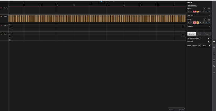

I used to have analog inputs recording on my logic 8 (with the logo on the front.)
However, this last session, whenever I go to record analog, I get nothing, no line, and apparently no reading.
The inputs still work for Digital, and I’ve tried unplugging and replugging to get it to work as well as tried lower sampling rates.
Any suggestions.?
