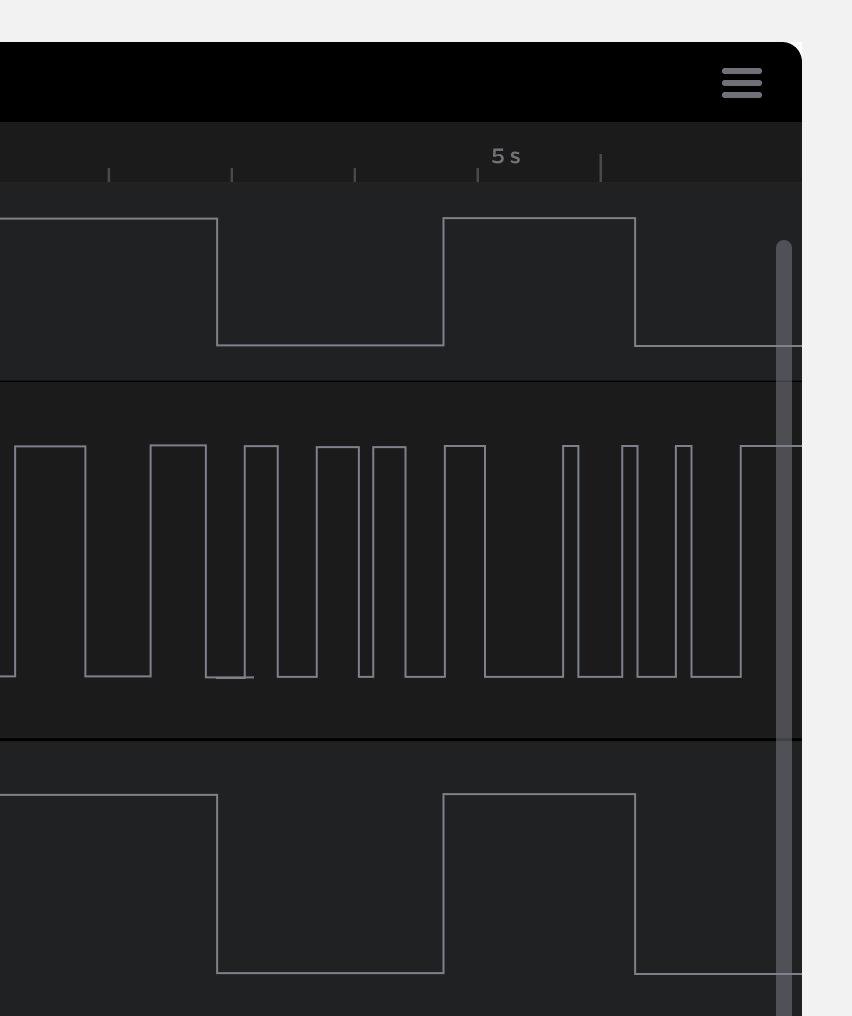

Here’s a UI mockup in the meantime. What do you think?

Joe - those mockups look AWESOME! Yes, that will work just fine and will be a huge help. Thanks!
Woo! Thanks Brian, we’ll make it happen!

Does the collapsing of the left and right panels (and resizing them) solve this do you think? (See UI mockup further up)
How’s this looking?
Better?
How about this?

It’s promising. I’ll have a closer look when the collapsable panels are implemented.

That’s much better.
