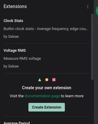

Also, the link to documentation does not work (do not open browser, at least not on Linux)
Screenshot from 2020-07-07 08-34-15
same goes for the “blog-link” in release notes, and links like “repository” and “report” in extensions.
