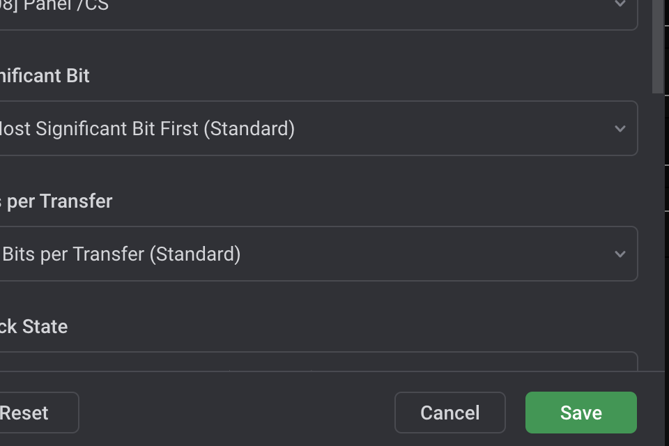

I used Logic 16 and Logic Pro 8 to debug SPI + UART of the same program against two different boards. Actually, the program was running successfully on one board but not on the other.
I don’t want to scroll down to configure SPI.
How to remove /RESET, Panel /CS, Flash /CS and alike?
Spot the difference between the two traces above.
How to go from CC1352 to FR5994?

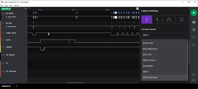

.logicdata file launches Logic and doesn’t load the file, when double-clocking on a .sal file launches Logic and loads the fileCan’t get trigger to scroll
I have 8 channels enabled and wanted to set the trigger on the last channel D10 in my example). I open up the Capture Settings then scroll down to “On what channel” and try to scroll down to D10. However, I can’t get there without growing the screen. Here is what I see when trying to scroll down.
The last one I can get to is D9:
However, if I grow the screen a little, I can scroll down to D10
Let me know if you need more info to reproduce this.

You can scroll, it’s just very tricky
Notice that there are 2 scrollbars, you need to scroll the outer panel and then the inner one.
Sorry about that…
Anyway, we fixed it on 2.2.9 that we’ll be release today!
