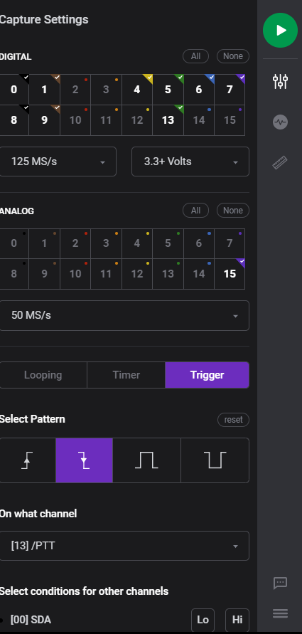

Long Capture Being Truncated
I setup a capture to run 23 seconds after the trigger, and it stopped after 10 with no messages. I can see the about of memory being used increasing to 2G and then it stops. I have 16G of RAM in my machine, so 2G is nowhere close to what it could use. The Digital channels are set to sample at 125 MS/s and the Analog channel is set to sample at 50 MS/s.
Notice that this time it gave me 9 sec pre-trigger, and less than 1 sec post trigger
Is there some reason that it cannot use more than 2G? I tried setting the option to trim to the last 5 seconds post-trigger, but that made no difference.

We just fixed the memory management system to notify you when we have to stop the capture. It’ll be available on the next version (in a week). We’ll also add an option to select the max memory usage.
My apologies for the bad experience :blush:
